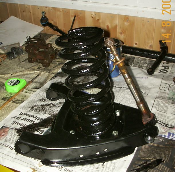

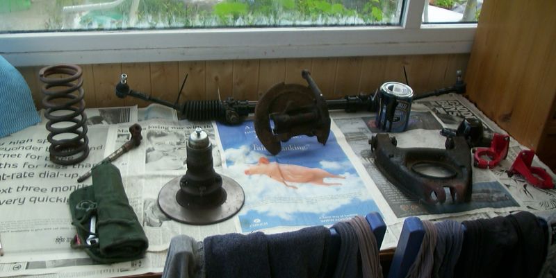

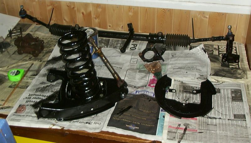

2003-11-10Rebuild Front SuspensionPassanger side king pin rusted into stub axelFitted new stub axel assemblyStub Axel assembly (Exchange unit)10751244.38
2003-10-14Rebuild front suspension driver sideBushes x 8, Cotter Pin, Grease Nipple, Grease plug + Sundry nuts10751217.00
2003-10-14Rebuild front suspension2 x Fulcrum Pin10751219.86
2003-10-14Rebuild front suspensionGrease nipple missing + long overdueNew lower wishbones cause old ones rusted to pin2x Lower Wishbone Pan10751262.11

2002-11-13Mega heavy steeringRusty bitsRemove clean rack. Replace Track Rod Ends.2 x Track Rod end10751219.86
